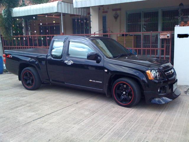

Hi new to the forum
I am living in Thailand and like the performance side of diesels and attach is a few pics of my 360hp 727nm of torque 2.5 liter diesel.

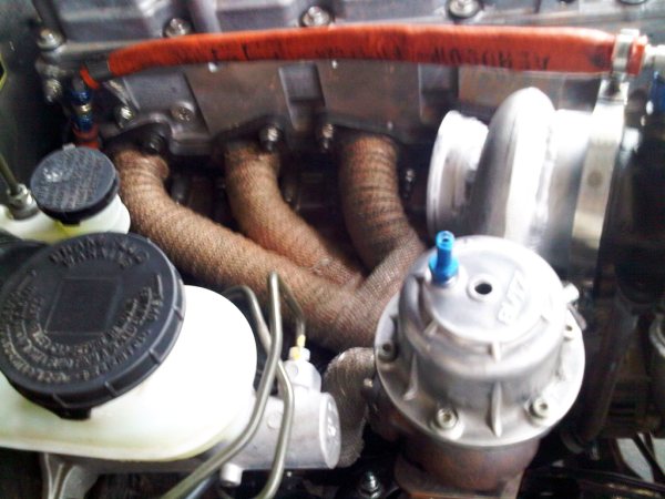

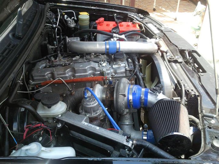

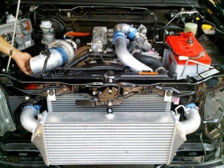

Skipped stage two and went straight to a stage 3 set up.
Which was
Hybrid Holeset/Borg warner turbo
Quick spool race manifold
Blitz waste gate
Large front mounted intercooler
Large 6 hole race injectors
Larger injector pump
Cold air intake
Running the same monster DSM kit from Power lab just re-tuned
Smart gauge set up
Cusso coil over race suspension
330mm disc with brembo calipers
Single plate race clutch
18” Nismo rims
Nitto street race tires
Custom 2.5 exhaust
Recaro race seat
Which was
Blitz waste gate
Cold air intake
Smart gauge set up
18” Nismo rims
Custom 2.5 exhaust
Recaro race seat
