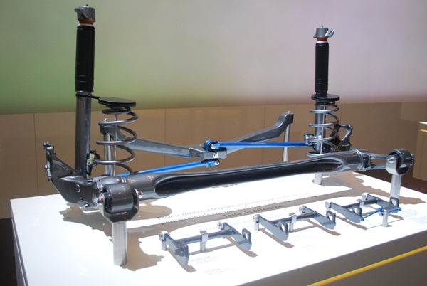

The Chevrolet Cruze uses a torsion beam as well, which Chevy calls a compound crank axle. I recall during the launch press conference that 'compound crank axle' was still an unfamiliar team to me, and to my surprise that Chevy's engineer assigned to face us during the conference could not answer my question if it was an independent suspension or not.
During my recent trip to the Paris Motor Show, GM displayed a mock-up of the compound crank axle at the Opel stand, but do note that the display features a Watt's linkage which is not included in the Cruze.

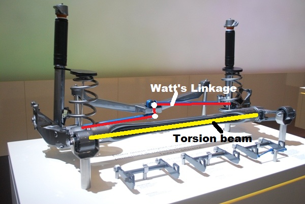

Hi Gunner,
which part is the Watt's linkage on the picture?
Posted 18 October 2010 - 08:12 AM
Hi benny, this modified picture should answer your question. Oh, and remember.. GM calls the torsion beam a compound crank axle.
