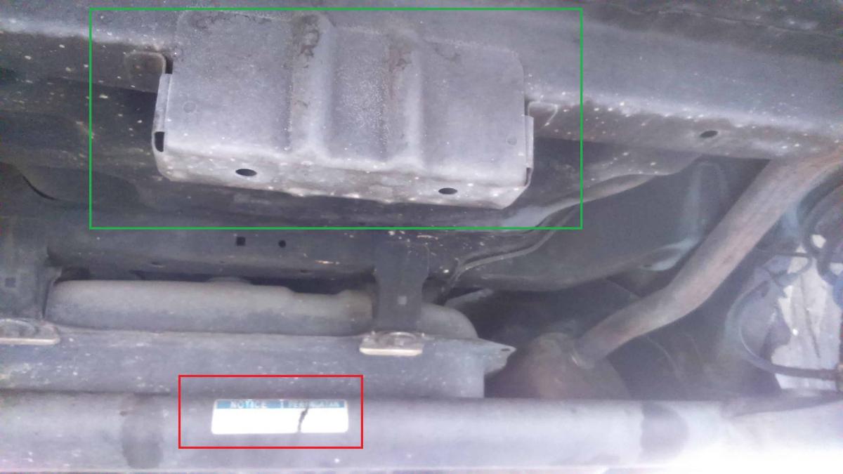

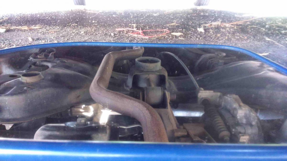

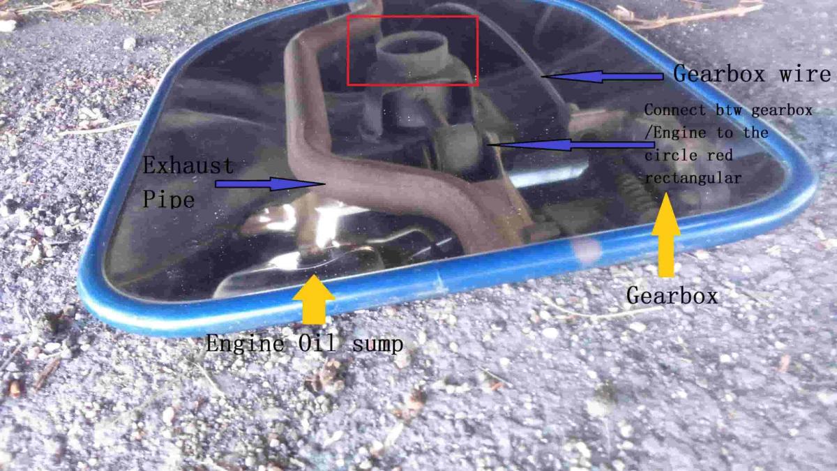

1. First question is can I use hydraulic floor jack to jack on the picture red rectangular part at the center, so after jacking up I can easily to two jack stands at the weld pinch jack point. I not sure what is it, maybe is mounting for engine or gearbox?

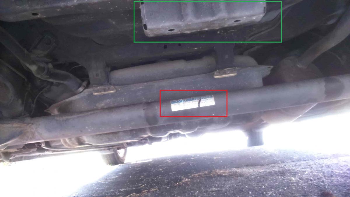

2. Second question is for the rear part. should we jack on the green rectangular part shown in the picture? Since there is a sticker at the torsion bar (Red rectangular), we cannot jack it , the green part just before the torsion bar I see is quite solid at attached to the frame, seem like a perfect jack point for rear center part.
*I just use mirror to took some pictures of the Myvi underneath. (I know it need imagination to understand my picture location since it is a bit hard to take photos of it).

I cannot remember but the User manual would specify exactly where to put the jacks.
AFAIK, the only valid points are those metal ridges below the doors because they were designed to take the load of the car.
