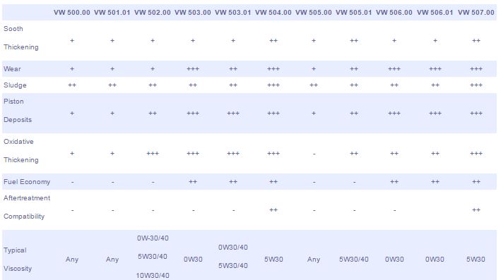

All those API reading are definitely the old school readings and we should not be following that up. The latest oil reading we should using for Audi and VW is the VW504000, which has good readings for wear, sludge, piston deposits,...etc etc..
Sara
sk472001
Posted 24 December 2014 - 12:34 PM
sk472001
  • 30 posts
Some charts for reference
