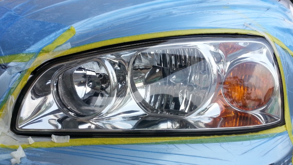

hlmaster
Posted 12 November 2014 - 07:32 PM
hlmaster
    3rd Gear
  • 3 posts
After apply Headlight master Restoration Spary

QUOTE (hlmaster @ Nov 12 2014, 07:32 PM) <{POST_SNAPBACK}>
Whats that, tell me more
