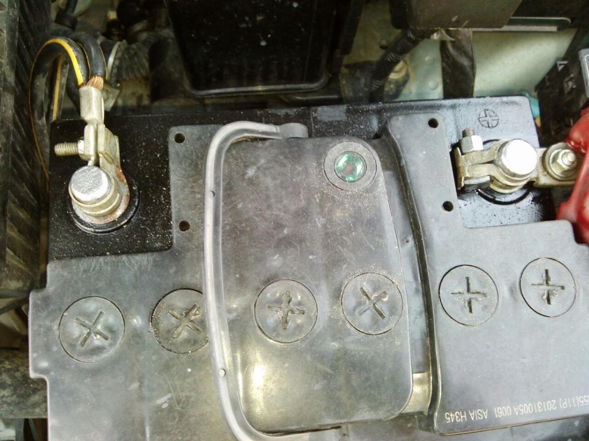

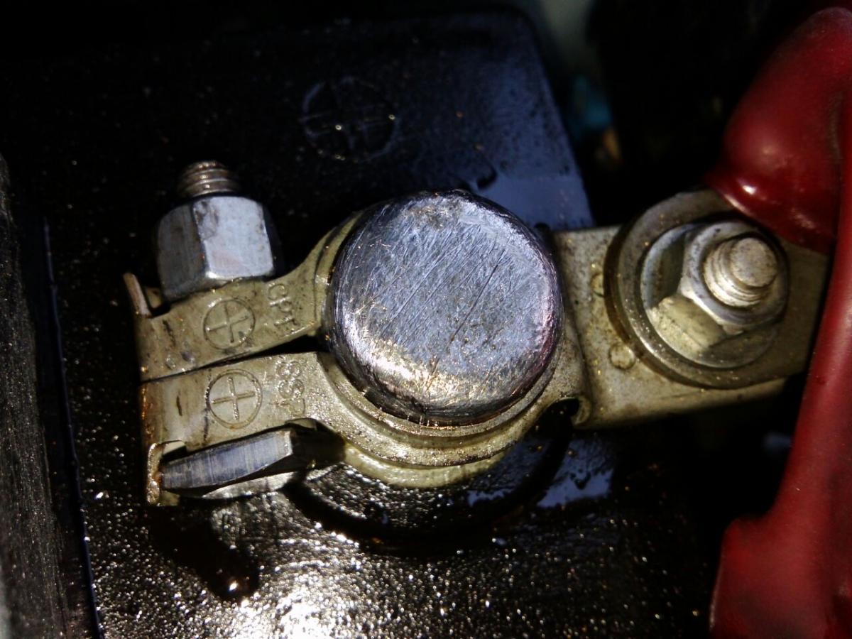

The flickering issue on my car had been restored.
After Visiting a wireman in my home town ( Bukit Mertajam -nearby Caltex Jalan Kulim)
All he did, was brush off the both battery point and the connector with metal brush to remove the oxide and rust..

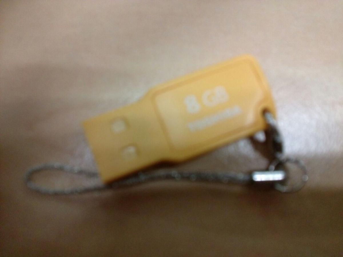

after that i change my metal USB Pendrive (MP3 songs) to plastic as in the below pic.
almost a week, i dont hv anymore flickering or dimming of lights..
hopefully this solve your issue as well.
