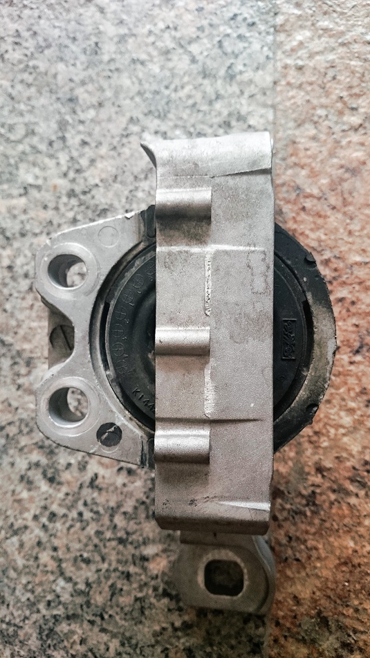

however, one issue i'm having is the vibration during idling is quite bad and it happens occasionally only. sometimes it's damn smooth. is there anything i should check on? so far i cant trace anything wrong and it doesnt happen all d time. slow acceleration will also gives the vibration occasionally. pening kephalar.
check your engine mounting, i've had my front driver side and rear mounts changed. my M5 is at 134k km now and still loving it.

Just had to replace another driver side motor mount. You can see from the stains on the metal parts (from the internal oil leaking out). That's when you know you've got a broken motor mount.
Costed me 580 including labour to change.
