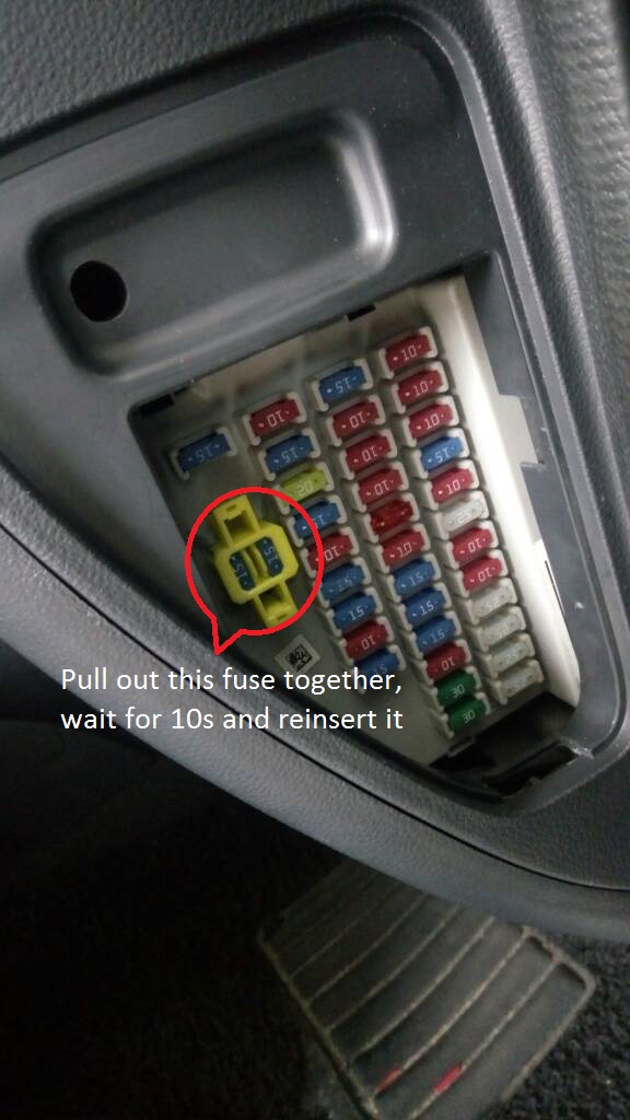

Hi,
Sorry to bring up the post again. I have faced the similar issue. It was first the brake light issue that was faulty which I think induced this problem for me. Since I have gained a lot to resolve my rondo issue from this forum, I would like to share my experience on this. Back to the story, basically what I did is, just pull out the memory fuse which is memory and aircond fuse (which comes together) and able to make the meters to work but it was temporary only. The meters are out again. Now, I have to look for new or used ones. Since our rondo are rare breed in M'sia, I m gona have a tough time
