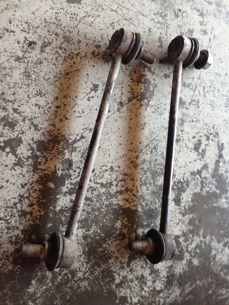

For the past few week my 09 Rondo has this sound when drive on uneven road. A check on SC confirm the stabilizer link give away. A furthered check to confirm this was to drive without this & no more sound coming from undercarriage. No part available yet & SC will help to check on price & stock availability.
Price update: 1 piece RM91 + 15% discount due to NAZA KIA year end promotion.

Anyone got this problem ? The sound is like knocking part coming from front undercarriage..

this is called absorber link

problem solved. year end spare part promo with 15% discount.. total cost RM150 for a pair.. No more sound.. solid like brand new car.
