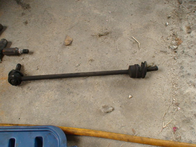

I open both front tyre to check front component suspension, find out that link rod is badly worn. After that i check on the coil plug, find out plug no.1 did not provide enough electric compare with the other 3. So i suspect the cable plug also worn out. After satisfy with car problem diagnostic, i go to asli auto to buy cable plug and link rod and plan to do installation on the next day
Today, sunday, i plan to install cable plug and link rod (because this thing is not required long time, i start to work at 5 PM before the disaster come).
Refer image below for the worn link rod, almost tercabut. (cannot use attachment here because of attachment limitation)
old link rod
After bought all the spare part, i'm going back to install new link rod. Below is my new link rod picture after installation.
new link rod

I bought the original citroen part which cost me 190 and bought it one pair which cost me 380.00. Spare part shop quote me 140 for italy brand unfortunately my link rod using big screw (dunno what name is as i labeled it as screw) and no italy brand available for that model. Nevermind, it will last long (more than 5 years i believe).
