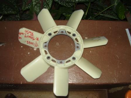

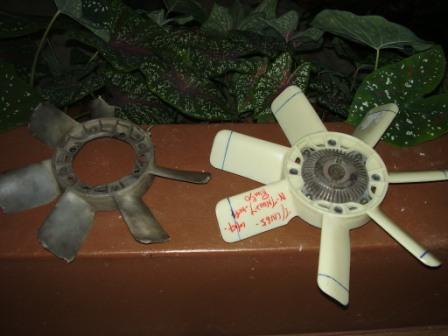

2 days before CNY the radiator leak due to fallen object. actually the air filter mouth is not properly thightened and fell onto moving fan.. due to that the fan blades snapped and hit the radiator .. apa lagi, berdarahlah feroza ku...
tomorrow im going to collect the radiator in Lukut near Port Dickson the place where msyuky and i used to hang out.

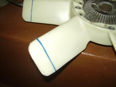

i got to replace the fan too. .. new original fan is about RM 240/piece without fan clutch...! there is no local made fan for feroza but i got an option.. i use toyota hilux fan.. it can be fitted to feroza fan clutch perfectly. the only issue is the length of its blades which is longger than feroza fan.
the toyota hilux fan blades is about 2.5 cm longger than feroza. need to cut that part in order to accomodate the fan into feroza engine bay. or else it will hit the radiator cover.
the cutting of each blades is quite tedious job becoz i have to cut it evenly to avoid imbalances. i have to carefully measure and cut the fan blades to make it look like same as the original unit.
the cost is just about RM 40 for hilux fan..
my fan clutch is still in good condition and it response to engine tempreture correctly. no need to replace.
