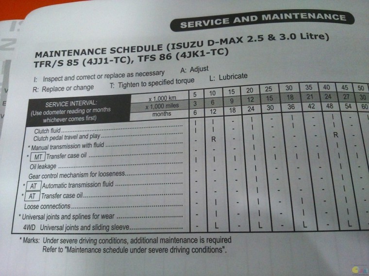

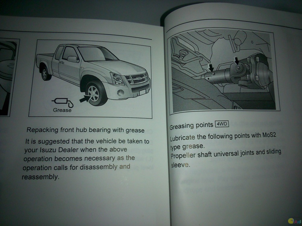

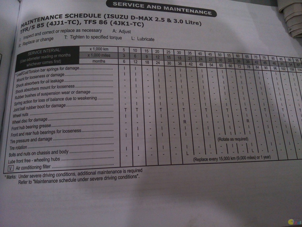

I own a Isuzu D-Max 3.0. From the owner manual,
1) The front bearing is to be repacked with grease at the interval of every 30000km.
2) The propeller shaft universal joints and sliding sleeve is to be lubricated with MoS2 type grease every 10000km.
My mileage is about 53000km now, and service center never do the bearing repack and lubricate the propeller shaft universal joints & sliding sleeve.
Is it a need to repack the wheel bearing with new grease as per owner manual, or just use until the bearing damage only change it?
How about the propeller shaft universal joints & sliding sleeve? Is it a need to lubricate them?

Just replaced the front bearing this morning. Total cost ~800 , most expensive cost over 5 yrs. Guess still acceptable if compares with others.
Tip to trouble shoot when bearing kaput:- humming sound when hit certain km/hr. Mine started when reach 80km/hr, deteriorate over few days. Getting louder then 60, 40km/hr also detected.
They say need to grease the propeller shaft n sleeve. Mine no 4WD so no need. But for the wheel bearing, no need to lubricate according to manual, just drive till kaput. Reason is old grease and sediment will fill up the worn off gap. If dismantle and grease might loosen the bearing and cause unnecessary noise. Ok, sound logical.
